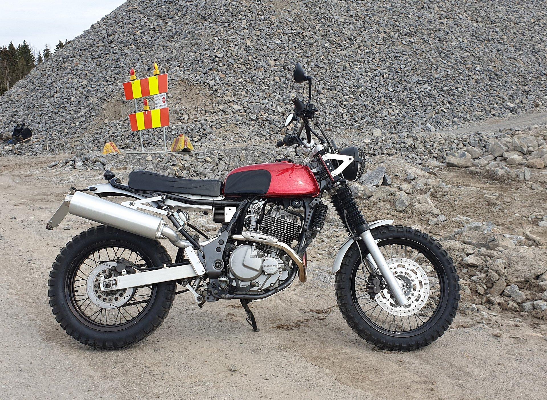

Hello,
After reading this forum (through google translator) for already a few years, I want to present my Scrambler conversion.

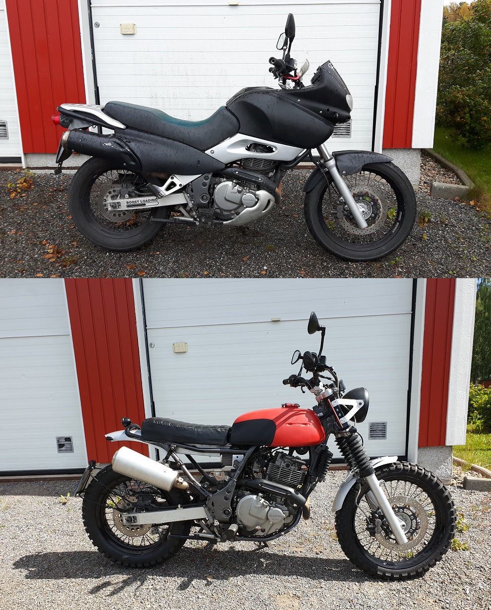

Going into the garage
Coming out of the garage after 2 years
New handlebars, footpegs and headlight grill
Tank: Honda CB350 Four, modified to sit properly on the frame.
Exhaust: Ducati Monster
Tires: Conti TKC80
Fenders, mirrors, lights: Kickstartershop, ebay, Louis...
Footpegs: KTM adventure with self-made mounting brackets.

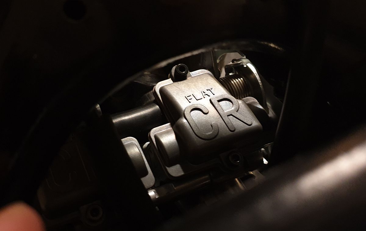

Something new :mrgreen:
Re: Scrambler aus Finnland (leider auf Englisch)
Nice build!
I like the rear frame end.
You got the first XF with cr-carbs ist have eher seen. 8)

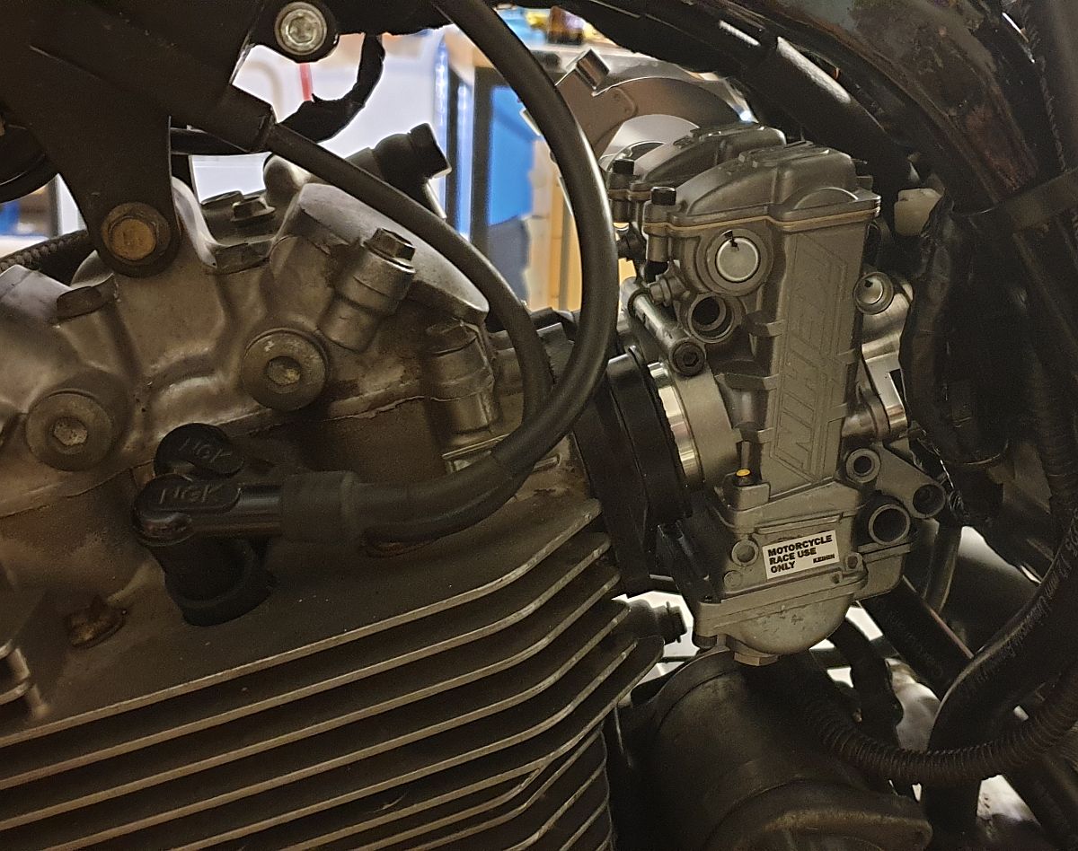

Hi Melitos
The sticker "Motorcycle Race Use Only" is very important for German and Austrian Police and TÜV. :mrgreen:
What did you pay for them?
Greetz
Tom

Thanks for your comments.
I am not aware of any other Freewind with different carburettors.
However some British have fitted round slide Keihin CR33 to CCM 644 motorbikes which use Freewind engine.
Here is CCM 644 https://www.youtube.com/watch?v=2jgH3Z10Bic
And here Keihin CR33 for CCM with Freewind engine https://www.allensperformance.co.uk/news/page/3/
I think I will remove the sticker :lol:
Luckily we have no TÜV for motorcycles in Finland. Also the Police are not too interested as long as you don't drive like stupid and not too loud exhaust.
Price for pair of Keihin FCR33 with fittings was more than what I paid for the whole bike when I bought it... :roll: Well over 1000 eur.
Keihin FCR or CR are probably the only options. Pair of Mikuni TM would be cheaper than FCR, but unfortunately cannot be built to such narrow space.

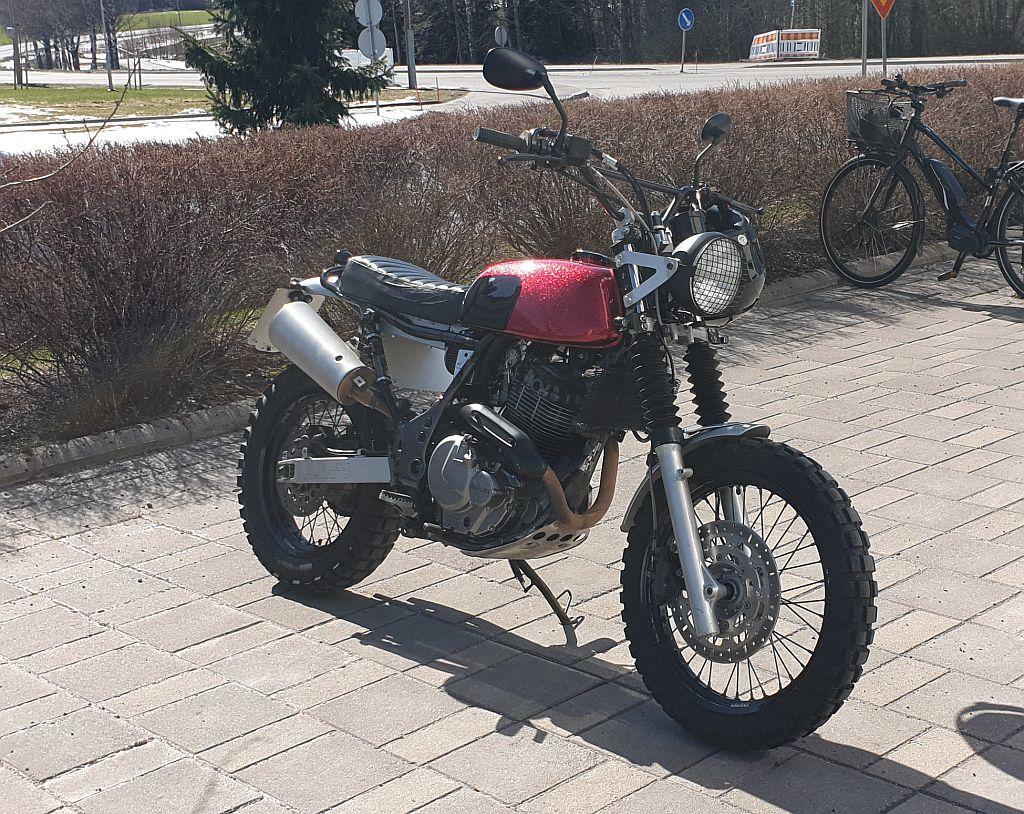

I am still alive, and so is my Freewind Scrambler.
It has been quite an effort to set the new carburettors properly. Had to special order new jet needles from Japan to lean the mixture. Jets I can buy from Finland but not the jet needles. Covid 19 is not really helping with delivery time for parts. I have had PLX wideband O2 sensor in the exhaust with bluetooth connection so that I can see mixture from my phone (which I have had attached to handle bars).
Now I have very good low speed cruising around town with smooth ride from 2500rpm and good acceleration all the way to rev limiter. Huge improvement over the original Mikunis even though some further tuning might be needed.
I also had a leak in my fuel tank which I noticed late last year so I used POR-15 tank sealer to coat the inside of the tank. The outside also got new professional paint with lots of flakes 8) The picture was taken already many weeks ago during first ride with new carburettors (and bike running with very rich mixture).
