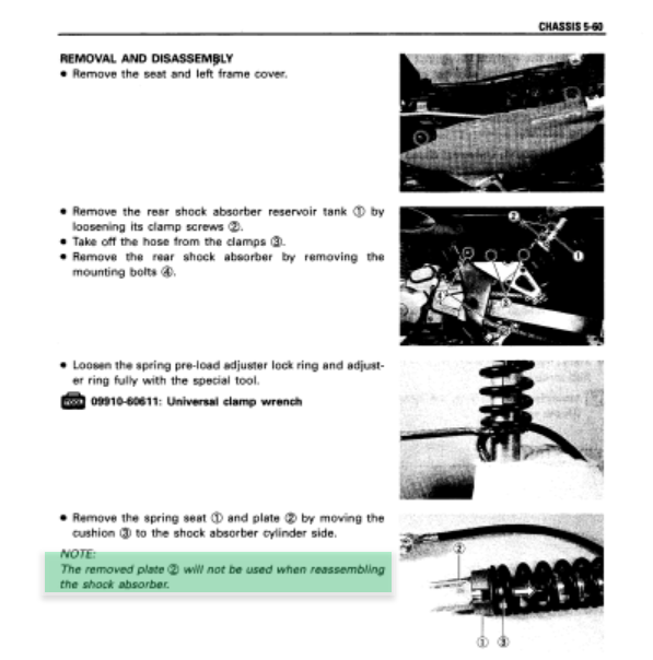

Yes it was the piston band o ring that was torn together with the piston band, it's the second time the piston band gets torn on me and second time the seal fails and oil leaks. I don't know why.
Anyway what does the the sentence I highlighted mean? Why not to put back the plate?

Maybe you're supposed to replace it with a new one?
Re: Federbein hinten
It's a kind of security clip, security ring whatever. I reused it and it should normally work. Just take care Not to damage it when disassemble the shock.
Remember or take a pic of the correct position, that's it.

After digging some info, I think they meant not to use the plate only if you lower the bike. The whole instructions there is about lowering the bike.
This plate is there probably to make it hard for users from lowering the bike without flipping the spring seat like they should, to prevent the wheel to touch the fender on strong compressions of the suspension.
